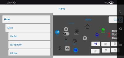

RE: Visu bugs - Chandrias - 23.10.2025
When accessing the new Visu app from my smart device, i see the menu on the left,
instead of just the screen I designed. Is this normal?
RE: Visu bugs - Daniel - 24.10.2025
Go to General settings and see the: Plan view menu display mode:

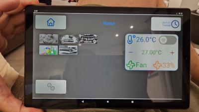

RE: Visu bugs - Chandrias - 28.10.2025
Is it possible to open visu on clients tablet in full screen mode?
As i see it now, there is a white strip in the area outside the area i designed.
RE: Visu bugs - Daniel - 28.10.2025
Use LM Home

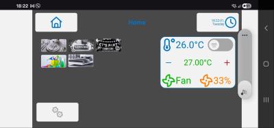

(28.10.2025, 16:16)Daniel Wrote: Use LM Home
This is the app I use, but there are white stripes above and below the screen. See picture above.
Similarly on another device, the stripes appear on the left and right.
RE: Visu bugs - Daniel - 29.10.2025
Go to Global appearance and play with Page background setting.

RE: Visu bugs - Chandrias - 31.10.2025
(29.10.2025, 08:04)Daniel Wrote: Go to Global appearance and play with Page background setting.
Still the same effect.
I thing it has to do with the way the application runs on the client device.
RE: Visu bugs - admin - 03.11.2025
@Chandrias, plan view is scaled automatically to fit inside of the whole screen while keeping the aspect ratio. Because different devices have different screen aspect ratios you get blank space on either vertical or horizontal edges.
As Daniel said, check Global appearance settings > General > Page background color. You can test it in your PC browser by resizing the window. Blank space will display the selected background color.

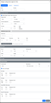

RE: Visu bugs - stianj - 06.11.2025
Ok... But maybe I have another bug for you then - still the light widget. If "Enable widget compact mode in Plan View" enabled, display mode is "Value" and "Show on/off toggle" is enabled - then "Additional values / icons" won't work. I want the value 0 to be the norwegian word "Av" instead of the default "Off". This works as expected when "Show on/off toggle" is disabled, but not when it's enabled...
Attached. When I turn off the GA with the wall switch, I can see it says "Av" for maybe quarter of a second, before it turns to "Off".
And again, as soon as I disable "Show on/off toggle", it's working as expected.
