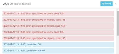

RE: Would IFTTT be possible to integrate? - Daniel - 12.07.2024 Why don't you just use google home app? RE: Would IFTTT be possible to integrate? - alexandrub - 12.07.2024 (12.07.2024, 09:54)Daniel Wrote: Why don't you just use google home app? I can't sync this. I receive fail code 135. RE: Would IFTTT be possible to integrate? - Daniel - 12.07.2024 Send a screenshot of the error RE: Would IFTTT be possible to integrate? - alexandrub - 12.07.2024 (12.07.2024, 10:16)Daniel Wrote: Send a screenshot of the error Also for Google app is not working the sync. error: sync call failed - /tmp/tmp.SDualGcUIm/files/store/cloud/config/google.lua:7: attempt to call global 'registerobject' (a nil value) - this is new one, after the snip was took. RE: Would IFTTT be possible to integrate? - Daniel - 12.07.2024 Send me your backup to PM. RE: Would IFTTT be possible to integrate? - Daniel - 12.07.2024 Enable password for apps in User access settings and make sure your LM is online in https://remote.logicmachine.net/settings then try syncing again RE: Would IFTTT be possible to integrate? - alexandrub - 12.07.2024 It doesn't work. The version is older for my logic machine. RE: Would IFTTT be possible to integrate? - Daniel - 12.07.2024 You probably must update firmware. Which one do you use? RE: Would IFTTT be possible to integrate? - alexandrub - 12.07.2024 (12.07.2024, 12:01)Daniel Wrote: You probably must update firmware. Which one do you use?HW: LM5 Lite (i.MX6) SW: 20210413 RE: Would IFTTT be possible to integrate? - Daniel - 12.07.2024 upgrade fw |
