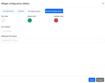

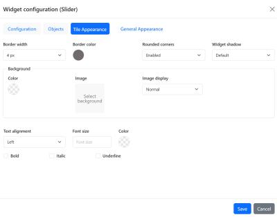

Hi ,
For example, In tile view , if we add a switch we will use tile text to tell customer via tile text what is control purpose. Therefore tile text in tile view is important . We would like to customize more . If you split appearance menu in widget like tile appearance and general appearance , you can add font change menu of tile text in the tile appearance menu and it will be no complex in my opinion. I added 2 pictures for my suggestion to tell what i mean.

It's not that easy, certain settings apply to both views depending on the widget. There's a global setting that applies background and border to plan view widgets. We'll add some info text to make it more clear where these settings can be used.

Ok. Customizing tile text is a need. Please consider. Any kind of text we put on the plan or tile , we need to change font color as a beginning at least.

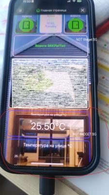

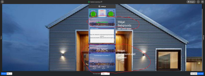

Now I am experimenting with background pictures.
1. I took 270x180 pixels picture jpg type. 13.16Kb size. At my PC in visu admin all is OK, but at my phone still background not seen. I see category widget background, not putted in widget picture (in attach). So where could be problem with background pic?
2. May be needed correction in settings - if we will use background picture - background color should be set to transparent, or we still see background color not picture..
Alex

RE: Feature requests - AlexLV - 19.08.2025
In attach PC view and Phone view.
At phone I not see widget backgrounds.

RE: Feature requests - Daniel - 19.08.2025
Ok, good, but what to do? Cache somewhere?
And at your pic still not seen temperature value in the middle of widget (white color used) and also not seen graph (should be white color and graph grid (gray color I used)..
