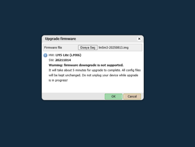

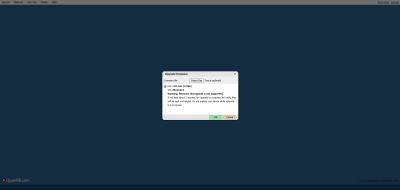

(24.11.2025, 09:43)Daniel Wrote: Are you downloading from the forum our from our website? Drop me a screenshot of the Upgrade firmware view.
RE: [RC1] LogicMachine firmware 2025.08 - Daniel - 24.11.2025
What is your serial number? see side label and what is exact LM model?
RE: [RC1] LogicMachine firmware 2025.08 - AEK - 24.11.2025
(24.11.2025, 10:11)Daniel Wrote: What is your serial number? see side label and what is exact LM model?
as I remember there were 1 fw in 2020 or 2021, wich could not be upgraded via web interface, and we need to refalsh sd card completly.. may be it is thes problem?
There was never case like this. This user is from Turkey and there is dedicated LM for this market which cannot use regular firmware. I think this is one of them.
RE: [RC1] LogicMachine firmware 2025.08 - metinsirin - 24.11.2025
LM5M3V192006405
6ULV22E20030243

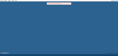

Hm, this is regular LM. Something is not right here. Make a backup and use the recovery image to upgrade fw and restore backup.
https://kb.logicmachine.net/misc/reflash-lm-and-streaming-player/
