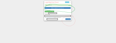

Daniel,
I found problem.
At LM cloud no any errors, just upload messages.
Problem - I always click Save button at LM cloud page, also I see that SYNC logo also changed, and I decided SAVE Button = Sync configuration.
Now I pressed after Save also SYNC button when I read your PM message, and all works.
So may be at cloud LM app part add message to remind also press SYNC button? It is confusing, because when I press SAVE, button, SYNC also show time changes and I assume sync also is done..
And it looks when I press SAVE, all changes saved but without new pictures and may be some other visu elements..
But good I found where problem was Smile
Alex

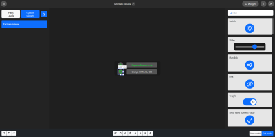

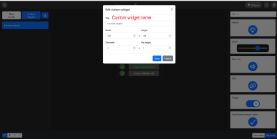

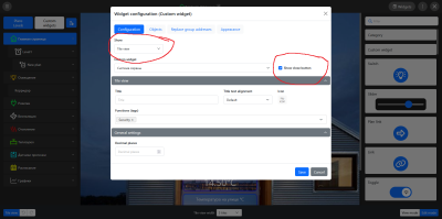

I started to create custom widgets, some recommendation/improvements:
1. In custom widget settings "title" I think should be changed to "Custom widget name". "title" will be seen again when custom widget will be added to visualization. Also in settings can be added custom widget export.
2. During custom widget creation I tried to use arrows in the lower part of the screen to move visualization objects. They not working (I use tile view). And would be good to add arrows to move objects to the left and to the right. When selected 2 or more objects, also could be good to have all 4 arrows (up, down, left, right) for moving all selected objects, not just for aligning them.
3. Should be reserved place for custom widget title, or just remind about it. I mean when I selected 3x1 tile size for custom widget, create it, and later added to visualization, when I write title and select icon, it was behind widget objects and not seen.
4. In tile view "Show close button" I think not needed..
Pictures in attach, hope will be clear what I mentioned.

The arrows are for stacking objects one above another, something what wasn't easily possible before. Same as in Powerpoint. You can use keyboard arrows to move objects. TIP, Try doing it with SHIFT.

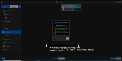

is possible for "value select" widget make windows with selection objects wider? I use it for tile view.
Alex

@AlexLV, value select window is scaled automatically based on the value length. You can set a fixed width via CSS but it will affect all controls that use pop-up windows:
.widget-control-dialog {   width: 320px; }
