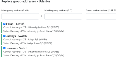

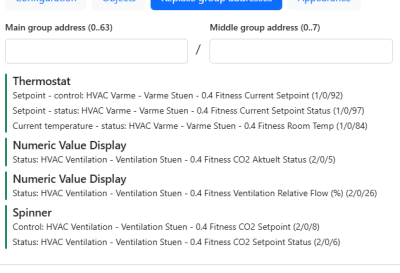

RE: Feature requests - Carlos Efintegra - 13.05.2026 I don't know if I'm repeating the request, but I can't find a widget for Sonos like Mosaic's, and user-configurable scenes, automations, and schedules, like Wiser's for KNX, would be ideal. Thanks RE: Feature requests - KoBra - 29.05.2026 1. ability to change the suffix on a thermostat to for example °F, K. Now it is fixed on °C 2. the ability to change the icon for actual value in the widget (or even remove it) RE: Feature requests - admin - 01.06.2026 @KoBra 1. For certain data types like scaling and temperature the units/suffix is added automatically if the custom units for the given object are empty. You can set the object units and it will be displayed instead of °C. There's a minor bug in AC/thermostat widgets where main object units are used for status display too. This will be fixed in the next version. 2. You can hide the icon using CSS: Code: .widget-thermostat .circularslider-status .icon {
display: none !important;
}RE: Feature requests - KoBra - 01.06.2026 (01.06.2026, 06:04)admin Wrote: @KoBra I updated also to the latest beta, now it works. I think i was still on an older version. RE: Feature requests - PolymorphedCust - 07.07.2026 Feature request: When replacing GA's for a page in, it's possible to check which widgets to replace the certian amount. This would be nice to have, when dublicating custom widgets. Like, to chose which widgets inside the custom widget, that has to follow the replacements. If that makes sence. RE: Feature requests - Daniel - 07.07.2026 The Plan/Layout/Widget replace feature from the menu is totally different from the one on Custom widget. The first is a real shift with change of address in the database where the one on custom widget is a virtual shift, we don't change anything in database only we apply the formula to the addresses. Due to this reason your request is not currently possible. |
