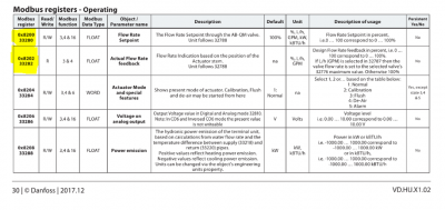

if someone can look into it , i attach the profile and the a piece of the datasheet of the valve into the reply.

so if i use following for writing to register 33280 , witch have functioncode 3,4 & 16 (datasheet)
{ "name": "Flow Rate Setpoint", "bus_datatype": "05", "type": "register", "address":33280, "writable": true , "value_delta": "0", "datatype": "float16" },
and for only reading the actual setpoint in register 33282 , witch have functioncode 3,4
{ "name": "Actual Flow Rate", "bus_datatype": "05", "type": "inputregister", "address":33282, "writable": 0, "value_delta": "0" , "datatype": "float16" },

RE: Help with a first knx to modbus - Daniel - 17.03.2018
You can use register for reead and write.
Use RTU read test to find correct settings. Most likely modbus dpt is nof float only int16
