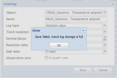

res, err = socket.http.request('http://admin:admin@127.0.0.1/scada-main/trends/save', post)
log(res, err)RE: How create scripts and trends by script ? - buuuudzik - 28.02.2018 First 6 trends are successfully created but another not and there is such res: Code: * arg: 2
* string: {"size":true,"success":false}
* arg: 3
* number: 200What means "size": true? I have enought space on LM and also RAM is ~50%. I've tried also to add trend via Editor and there is such error. I didn't know that there is a limit in trends? I have only 24 trends on this LM. RE: How create scripts and trends by script ? - Daniel - 28.02.2018 Hi Trends do have a limit to make sure you will not eat whole ram. It is around 30MB or something like that. Use lower resolution or shorter period. BR RE: How create scripts and trends by script ? - buuuudzik - 28.02.2018 But it is variable because on LM-LB it is ~limitless and I also remember another LM4 and probably I had there much more than here. What is the limit or dependancy(e.g. 50% of RAM)? I will consider it on planning
RE: How create scripts and trends by script ? - Daniel - 28.02.2018 This limit was implemented in latest fw I think. In the past there was no limit and we had cases when whole ram was used and device was rebooting all the times. It is around 30MB. RE: How create scripts and trends by script ? - buuuudzik - 28.02.2018 (28.02.2018, 12:03)Daniel. Wrote: This limit was implemented in latest fw I think. In the past there was no limit and we had cases when whole ram was used and device was rebooting all the times. It is around 30MB. But this is same on every LM or e.g. power version and Load Balancer has more. Could you check this? I understand that there was such need. RE: How create scripts and trends by script ? - Daniel - 28.02.2018 All devices have the same CPU now, in other words all of them are power now. Old and new devices have the same firmware. We phased out LM BL and you can't buy it anymore. We can generate new fw for them on request. In some time from now we will have new HW with even faster CPU and double the RAM. This will be nearly the same as LM BL. We could increase limit for trends then. |
