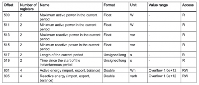

Modbus Double datapoint type - josep - 30.07.2018 Hello, I'm trying to connect via Modbus RTU with Siemens Sentron 3100 and the energy value is defined as a Double, how can I define it into LM json archive, thank you very much. RE: Modbus Double datapoint type - admin - 31.07.2018 Hi, double support can be added to modbus plugin. I can provide packages if you are willing to test this. Which firmware and hardware versions are you using? RE: Modbus Double datapoint type - josep - 31.07.2018 (31.07.2018, 06:58)admin Wrote: Hi, double support can be added to modbus plugin. I can provide packages if you are willing to test this. Which firmware and hardware versions are you using? Hi, I have a LM5Lp and the last firmware version (20170927). Thx RE: Modbus Double datapoint type - admin - 31.07.2018 Install through System Config > Packages and reboot: https://dl.openrb.com/pkg/genohm-scada-modbus_20180731_imx6.ipk https://dl.openrb.com/pkg/luamodbus_20180731_imx6.ipk In profile you can either use float64 or double. Mapped object should have float32 data type. RE: Modbus Double datapoint type - josep - 31.07.2018 OK thank you very much I have another doubt, I have modbus variables that are int32 variables of temperature or power values multiplied by 10, I have tried to use the option to adjust these values in the Modbus definition using 0.1 but I do not know what type of data I have to use in KNX to represent a 32-bit float value. The only option that I have found was to create a new variable and make an intermediate script that divides me by 10 the value read from Modbus. Thank you very much. a greeting RE: Modbus Double datapoint type - admin - 01.08.2018 Set bus_datatype to either float32 or float16 and set value_multiplier to 0.1 RE: Modbus Double datapoint type - Ibrahim - 18.11.2020 Hello, This is old post but I need to help about same issue. I can use double point in profile like below for double points and I selected 8 byte in objects to link this point but the value is getting too big. "datatype": "double", "bus_datatype": "double", "type": "register", If I select 4-byte floating point, it looks "-" The logic machine version is : HW: LM5 Lite (i.MX6) , SW: 20191015 What is the correct point for double? Thanks. RE: Modbus Double datapoint type - admin - 18.11.2020 Use float for bus data type, double is not supported as an object data type but modbus can read double values RE: Modbus Double datapoint type - Ibrahim - 20.11.2020 Thanks admin. |
