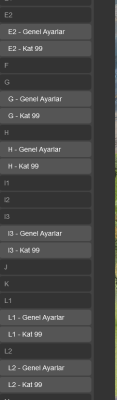

Dear All,
I am having a large project with 60+ rooms to visualize which will be grouped by floor and I would like to avoid a long scrolling list on the sidebar. I like the docked sidebar and the function when clicking on the right side (arrow) of the Folder Title a new tab will open showing only the items contained in the particular subfolder but I would like to ask how could I create a custom function by clicking on the Subfolder title to toggle between Expand and Collapse of the items that are under it. Please see the attached photo.
Thank you in advance.

RE: Sidebar Subfolders Expand/Collapse Items Option - Daniel - 17.09.2018
No photo Smile
RE: Sidebar Subfolders Expand/Collapse Items Option - manos@dynamitec - 17.09.2018
(17.09.2018, 09:26)Daniel. Wrote: No photo Smile
Hello Daniel.
Thank you for your indication.
Updated! Forgot to click on the Add Attachment button  Rolleyes
Regards,

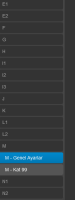

RE: Sidebar Subfolders Expand/Collapse Items Option - Simuzer - 13.06.2024
hi all,
Is it possible that only one open by cliick ?
I don't want it to be open more than once.
Thanks for now.
RE: Sidebar Subfolders Expand/Collapse Items Option - admin - 13.06.2024
Try this:
$(function() {   var plans = $('.nav li').not('.disabled');      $('.level').on('vclick', function() {     var li = $(this), sub = [];          while (true) {       li = li.next();       if (!li.length || li.hasClass('level')) {         break;       }              sub.push(li.get(0));     }     plans.each(function(_, li) {       if (sub.indexOf(li) < 0) {           $(li).addClass('hide');       }       else {         $(li).toggleClass('hide');       }     });   });      plans.addClass('hide');      var li = $('.nav .active').prevAll('.disabled')[0];   $(li).trigger('vclick'); });
