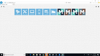

NAT port to access to LM5 - Triet Phan - 18.12.2018 Hello, I would like to remote access to the operation interface as attached image via NAT port on my home internet router but i dont know which port i would choose for using NAT method. I tried Port 80 but it doesnt work. I only use for remote diagnostic and commissioning into LM5, not for operating. thanks RE: NAT port to access to LM5 - admin - 18.12.2018 TCP 80/443 is for web server, UDP 3671 is for KNX tunneling. |
