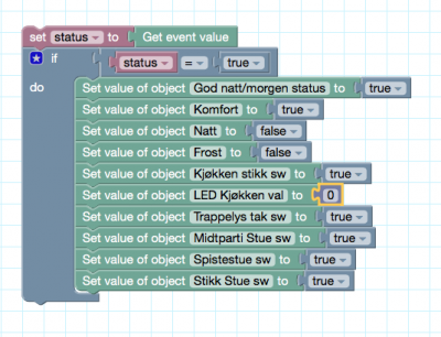

For the house status objects (home, away, vacation, good night, good morning) I´ve created block programs, so my clients can easily change the content for each script.
I´m having problems setting values though. If I choose:
Set value of object (some value object) and connects this with the math number block, I can only assign it a value between 0 and 9. One of my status scripts have the correct values though, but if I try to edit them now I can never go above 9 again.
Is it a bug?

Can you provide a screenshot, which browser are you using?
RE: Block Programming - FatMax - 12.01.2016
I´m using the latest Safari on Mac.
You´ll se 0 in the math box here, but i actually typed 20.
Just downloaded chrome and it works fine there. A bug in Safari apparently! Thanks! Smile
