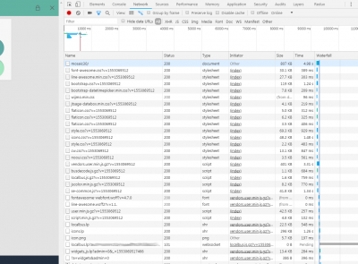

I've checked today on the latest firmware and situation is the same, and also with Mosaic, Visu and Apps, all files instead fonts are downloaded again on every refreshing by F5. I have the same on Firefox, Chrome and mobile. At the same time when I've downloaded other page e.g. www.onet.pl or google.com a lot of content is downloaded from disk.
RE: Caching files on client - buuuudzik - 20.03.2019
And e.g. Mosaic 3.0 only wijmo.min.css. Bootstrap and other libraries aren't cached. Apps view is cached (all icons and libraries) only widget isn't.
I've attached screenshots.
