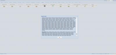

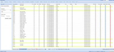

You probably have "bus sniffer" active. LM reads some of the adresses from the bus before you import ESF.
Kai-Roger
Deactivate this (see picture)
Delete the adresses in LM.
Do the import.
Reactivate bus sniffer (see picture)
It's altso better to import the whole KNX project file to this converter (Not ESF).
http://openrb.com/knxproj/
Remember to check off: "Include parent level names in object name" before converting.
And import as JSON in LM (The button on the right side off the ESF button)
You then get all names from the maingroup and middelgroup altso in the object names in the LM !

It worked perfect. Thanks.

The new import will not overwrite changes. The conflicted adresses will just get discarded. Before your next JSON import, you can deactivate the bus sniffer, and then "mass delete" all unnamed objects (if all object you have imported today has a name offcourse). This way you will clean out all new adresses that will be sniffed from now on.
