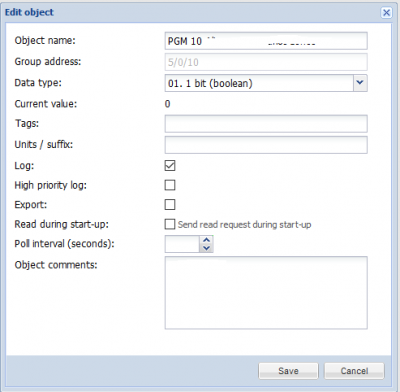

strange group address broadcast on LM? - puntukas - 30.05.2019 Hi! I have Paradox alarm system getaway connected to my KNX bus. Constantly I get one PGM event (value 0) on specific address several times per day even nothing really happens there (this event is for alarm restore, normally it occurs then systems restores from alarm). I thought it was Paradox fault, however logs show that LogicMachine (x.x.200) generates this event first and then paradox gateway (x.x.102) comes into the scene (see picture). Paradox log shows no events from system at all on this time. Could anybody explain this or point any ideas what's happening? Thanks a lot. RE: strange group address broadcast on LM? - admin - 30.05.2019 Check if you have poll interval set for this object. RE: strange group address broadcast on LM? - puntukas - 30.05.2019 Hi, thanks for such quick replay. No, no poll interval. There is no noticeable intervals between these false values - there could be three per day with various intervals or just one. Thanks. RE: strange group address broadcast on LM? - Erwin van der Zwart - 30.05.2019 Hi, Use ETS monitor to find out what physical device is sending the read request. BR, Erwin RE: strange group address broadcast on LM? - puntukas - 30.05.2019 Hi, Erwin. I will try, thanks! RE: strange group address broadcast on LM? - puntukas - 01.06.2019 (30.05.2019, 16:28)Erwin van der Zwart Wrote: Hi, Hi, ETS shows the same - LM generates some request - Paradox GW answers. How ever I cant find any peace code that generates requests. As you can see from log - LM generates requests to addresses from 5/0/7 to 5/0/11. What piece of code shall I look for? Or there could be another problem? Thanks. RE: strange group address broadcast on LM? - admin - 01.06.2019 Maybe you have a script which sends read requests. You can search all scripts by opening Scripting > Tools > Print script listing. RE: strange group address broadcast on LM? - puntukas - 01.06.2019 yeah, what command generates such behavior? there are no grp.read anywhere. RE: strange group address broadcast on LM? - admin - 01.06.2019 Object logs entry should display local instead of physical address as source when LM is sending the telegram internally so it's probably coming from somewhere else. Do you have any other KNX/IP devices on the same network? RE: strange group address broadcast on LM? - puntukas - 01.06.2019 No, only LM. LM object log shows 1.1.200 (that is LM) on any event logged, not only on this one. RE: strange group address broadcast on LM? - admin - 01.06.2019 Attach a script to this object, enable execute on read. Source: Code: log(event.sender)This might tell where the telegram is coming from. RE: strange group address broadcast on LM? - puntukas - 01.06.2019 Okay, thanks. Done, and wainting for telegram. RE: strange group address broadcast on LM? - puntukas - 07.06.2019 Hi, LM log(event.sender) shows "bus". what shall I do next? Thanks! RE: strange group address broadcast on LM? - admin - 07.06.2019 bus means that telegram comes from outside of LM. Try changing LM physical address and multicast address if Routing is not used in your project. RE: strange group address broadcast on LM? - puntukas - 09.06.2019 Hi, thanks. You mean to change physical KNX address in my case 1.1.200? RE: strange group address broadcast on LM? - admin - 10.06.2019 Yes RE: strange group address broadcast on LM? - puntukas - 11.06.2019 changed knx address, changed multicast address, rebooted - two wrong group telegrams generated just after reboot. Can't catch this moment with ETS, because while LM rebooting - there is no interface for KNX/IP. LM log for this object shows the same - "bus". Rebooted 3 times - everytime after reboot - two telegrams for 5/0/10 with "0". Any ideas? RE: strange group address broadcast on LM? - Daniel - 12.06.2019 Anything in start up script? RE: strange group address broadcast on LM? - gtsamis - 12.06.2019 I have had a sort of same situation with a specific Paradox to KNX gateway, can you please provide the manufacturer of the gateway? I might have a suggestion. RE: strange group address broadcast on LM? - puntukas - 13.06.2019 Daniel: yes, sending two telegrams to different group address. Nothing connected to address in trouble. GTSAMIS: tokka EVO096. Thanks everyone! |
