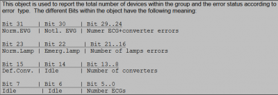

what kind of format is needed to use
"groupe failture status, alart"
best
RE: Schneider - Touch Dali - Daniel - 23.08.2019
12. 4 byte unsigned integer

please give me a hint how to use it.
my ABB Gateway will give 3 status bits back.
50000 EVG Error
100000 15 Lamps Temprature Failture
is there a list?
Like this
