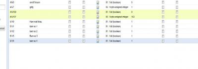

Hi everybody ! I have a difficulty, I have 4 addresses 5/1/1; 5/5/2; 5/5/3; 5/5/4. How do I know in which order I have clicked one by one? For example:
I press one by one: 5/1/1; 1/5/3; 1/5/4; 5/1/2 ->, then I know the turn is 1,3,4,2. My intention is to make a password.
I press one by one: 5/1/4; 1/5/2; 1/5/1; 1/5/3 ->, then I know the turn is 4,2,1,3
Does anyone have a solution for it, or anyone who has ever done it. Hope everyone help me! Thank so much!

You can always check the update time and sort them from oldest to latest.
RE: Password for keypad! - phongvucba - 11.06.2020
Yes, It's right !
We use the function os.time() or os.microtime() ?
thank everyone !
RE: Password for keypad! - Daniel - 12.06.2020
Single object update time you collect like this
myobject = grp.find('0/0/2') log(myobject.updatetime)
You can do the same with multiple objects when using tag for several objects.
myobjects = grp.tag('TAG') for _, object in ipairs(myobjects) do   log(object.updatetime) end
