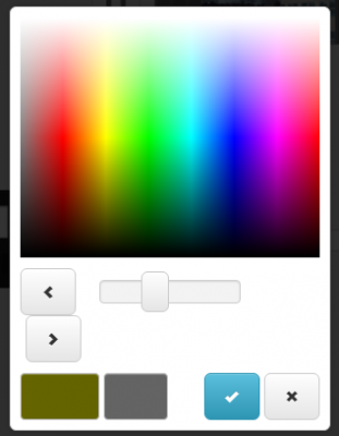

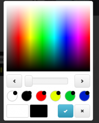

How to use new datatype RGB-W - gdimaria - 14.08.2020 Hi, I already know how to use RGB datatype (by a little tutorial by schneider), so I can split the value to the 3 objects (Red, Green, Blue) and viceversa. Now how I can do with RGB-white? And I tested it on visualization but it seems to me a little confusion RE: How to use new datatype RGB-W - Daniel - 14.08.2020 What is that you want to use it for? There is dedicated dpt for it and some KNX devices support it. RE: How to use new datatype RGB-W - admin - 14.08.2020 Which browser are you using? The slider is not displayed correctly. Are you using zoom/scaling? RE: How to use new datatype RGB-W - gdimaria - 22.08.2020 (14.08.2020, 12:59)admin Wrote: Which browser are you using? The slider is not displayed correctly. Are you using zoom/scaling? Chrome without any scaling... same on Firefox and Edge. I just want to let the user to click on RGB-W icon to set it. On the other side I would like to update the value when I set it with a script. That's a ordinary conversion I do with a script for a RGB: Write to RGB ---------------- Red = bit.rshift(bit.band(value, 0xFF0000), 16) Green = bit.rshift(bit.band(value, 0xFF00), 8) Blue = bit.band(value, 0xFF) grp.write(redGroup, Red, dt.uint8) grp.write(greenGroup, Green, dt.uint8) grp.write(blueGroup, Blue, dt.uint8) Read RGB ------------ red = grp.find(redGroup) green = grp.find(greenGroup) blue = grp.find(blueGroup) redHex = red.datahex greenHex = green.datahex blueHex = blue.datahex RGB = lmcore.hextoint(redHex..greenHex..blueHex) grp.update(rgbGroup, RGB) Now how I a can do the same with a RGB-W object, which is made up of 4 scale % objects: RED - GREEN - BLU - WHITE? Thanks. Peppe RE: How to use new datatype RGB-W - Erwin van der Zwart - 23.08.2020 Hi, Use this for 4 byte RGBW: Code: value = event.getvalue()

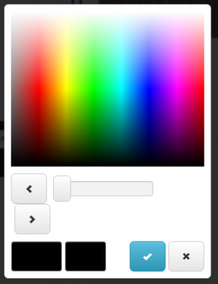

grp.write(rgbwGroup, RGBW)RE: How to use new datatype RGB-W - gdimaria - 26.08.2020 (25.08.2020, 15:43)Erwin van der Zwart Wrote: Hi, yes, I noticed it and fixed, thanks. Here another issue with visualization (see attached pic): what are the black spot on preset? How to avoid that? RE: How to use new datatype RGB-W - admin - 26.08.2020 Black spot is W value of RGBW RE: How to use new datatype RGB-W - Daniel - 26.08.2020 This is the white status. Change the white value and it will have different colour RE: How to use new datatype RGB-W - gdimaria - 26.08.2020 (26.08.2020, 08:12)Daniel. Wrote: This is the white status. Change the white value and it will have different colour Ok sorry to not understood!

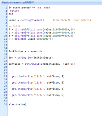

RE: Urgent! - gdimaria - 18.09.2020 Sorry, my script was working on the LM (firmware 20200720) in our office. Today I restored it on a new LM (firmware 20200727) at customers' and it doesn't work and give me the attached warning. We are blocked now. Can you please help me? Thanks Peppe RE: How to use new datatype RGB-W - Daniel - 18.09.2020 Paste the script as a code not image |
