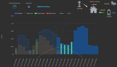

RE: Dynamically change the Scheduled program time parameters from visualization - Amelie - 29.02.2024 In the end, I want to charge my home battery at time x and decharge my home battery at time y. And, I want to be able to change x en y easily using the visualization, so that my husband (who knows nothing from the LM) can change the hours. Because the use of the battery depends on the seasons, sun, energy consumption,... Also the amount that the battery had to charge, is a variable. The purpose is to load the battery during night and to use the stored power during day, when the electricity is more expensive. I already know to manipulate the battery and I already have a script that starts loading the battery at 10 o'clock and start recharging it at 6 o'clock in the morning. Now, I'm trying to write a script to change the 10 o'clock and the 6 o'clock. But, during programming and to make the problem a bit easier, I've made a group adress which changes from 0 to 1, at 10 0'clock and changes from 1 to 0 at 6 o'clock. This is just a setup to test my script I'm trying to write. I've divided the big problem in a lot of little steps. RE: Dynamically change the Scheduled program time parameters from visualization - fleeceable - 01.03.2024 (29.02.2024, 20:39)Amelie Wrote: In the end, I want to charge my home battery at time x and decharge my home battery at time y. And, I want to be able to change x en y easily using the visualization, so that my husband (who knows nothing from the LM) can change the hours. Because the use of the battery depends on the seasons, sun, energy consumption,... Also the amount that the battery had to charge, is a variable. The purpose is to load the battery during night and to use the stored power during day, when the electricity is more expensive. Hi! If you want change charging and discharging times manually I would create resident script and use some virtual group addresses. Example: Code: --RESIDENT SCRIPT WITH SLEEP INTERVAL 1 SECOND I don't know what is your bigger plan and your specific needs... I have made automatic charging and discharging system to my clients what does charging and discharging automatically (plus it's possible to discharge on max power back to grid when electricity price is high - this is mostly used in summer). Everything runs via resident script and using scheduled script only to request electricity price. Maybe here is some inspiration for future scripting... Blue - El. price Yellow - Sun angle Green - Buying from grid Red - Selling full power to grid (not used right now) Dotted line - Cloud index Brown - Battery percentage RE: Dynamically change the Scheduled program time parameters from visualization - admin - 01.03.2024 For simple timed on-off control you can use a scheduler. No scripts are needed. |
