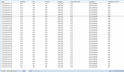

Oke, but i like to have my values with 0,1 precision.
With a arduino and the same type sensor i can do this (theoretical ), but connected to the LM4 it gives strange results: see attached picture.

You can add an event-based script which repeat this value with custom precision or you can use custom values for visualisation if this is only for visualisation purposes.
