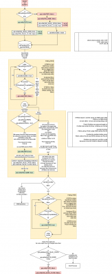

In attachment my script flowchart, which makes it easier for me to see what happens.
Below my current code (some variables are not used/needed in the script but still present)

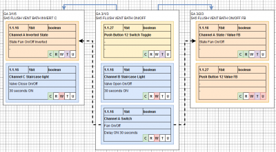

I would implement as much logic "in KNX hardware" as possible. Do you have actuators with built-in timers, i.e. if its capable of controlling shutters, it can most likely implement full logic on turning on/off power for you. Writing such logic in code if you're not a developer can most likely lead to random errors.

I didn't have any knowledge about logic functions and how to use and implement them.
Thanks to your comment I took the time to learn about logic functions in knx which led to a solution!
No logic is needed but only some parameter settings with the inverted state of the fan object.
