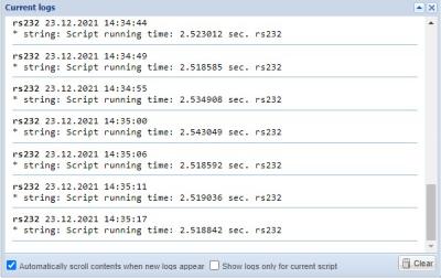

Resident script - sashhun - 23.12.2021 Hello. I noticed that when a resident script is executed with an interval of 3 seconds, the log about the script execution time is recorded with an interval of 5-6 seconds, respectively, and the data that I receive via rs232 is also recorded with this interval. Why is the logging time inconsistent with the resident script interval? RE: Resident script - admin - 23.12.2021 Your script is running for 2.5 seconds plus 3 seconds sleep time. The total is around 5.5 seconds so you get logs each 5-6 seconds because the time is rounded to whole seconds. |
