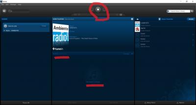

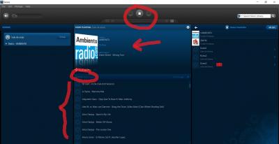

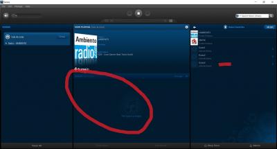

I send you some attachments that recreates the problems:
LOADPLAYLIST: see loadplaylist.jpg
PLAYURI: when i am listening a radiostation with an empty queue (see Playing radiostation with empty queue.jpg), and then i execute PLAYURI
Code: http://192.168.0.91/apps/data/sonos/sonos.lp?action=playuri&ip=192.168.0.14&listtype=favorites&listnumber=5
the list number 5 is loaded in queue but the queue appears "not in use" and the radiostation continue playing (see Playuri after radiostation.jpg)
You say that the command playuri starts playing directly, but it don't start. If i send a PLAY command, no action is executed in Sonos, because it is playing radiostation.
LOADURI: After execute this command:
Code: http://192.168.0.91/apps/data/sonos/sonos.lp?action=loaduri&ip=192.168.0.14&listtype=favorites&listnumber=5
No changes in the queue (see after loaduri.jpg)
NOTE: Playuri works perfectly when the queue "is in use" before sending the command. Maybe missing a command to put the queue "in use" - "not in use" ??
