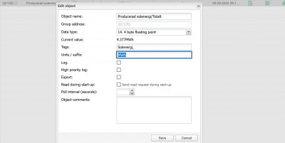

Is it possible to change this Unit/Suffix automatic it the value is over a specific number?
I run this script in resident and have it to calculate the number thats presented, but then I also need to change Unit/Suffix from kWh to MWh so theres no confusion : )
Is this possible to implement in my script or can´t this be done?

Changing units via grp.create will require UI reload for new units to appear.
You can use string data type instead of floating point for value display:
value = r1 * 0x1000000000000 + r2 * 0x100000000 + r3 * 0x10000 + r4 if value > 999 then   units = 'MWh'   value = value / 1000000 else   units = 'KWh'   value = value / 1000 end value = string.format('%.3f', value) .. units grp.checkupdate('32/1/54', value)

Do I have to make a new object by using grp.create for me to be able to change the units? Or can I somehow just change the units in my already created object thats not created by grp.create?
RE: Change Unit/Suffix automatic - admin - 09.08.2022
grp.create can also update existing objects' properties. But as I've said you won't see this changes in the visualization unless you do a full reload.
