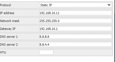

RE: Can't open app in LM. - Alexander - 25.10.2022
Hi, see postet pictures.
I think everything is ok.
When I press the + button, the loading screen comes, but closes again
RE: Can't open app in LM. - admin - 26.10.2022
Try installing firmware 2021.12: https://forum.logicmachine.net/showthread.php?tid=3755
