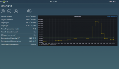

grp.checkupdate('5/5/26', max)
grp.checkupdate('5/5/27', min)RE: Read data from website and import them into objects. - robikozo - 18.11.2022 Hi, How do you execute this script? RE: Read data from website and import them into objects. - sx3 - 18.11.2022 Vattenfall release tomorrows prices aprox at 15.00 (Swedish time) At midnight at 00.00 I execute a scheduled script that fetches todays prices. And also I have a scheduled script that executes 15.00 and fetch tomorrows prices. 1-24 GA for hourly prices. TODAY 25-27 GA for min/max/median prices. TODAY 28 GA for datestamp for later verification that I have latest fetch. 29-54 GA for hourly prices. TOMORROW 55-57 GA for min/max/median prices. TOMORROW I then send all of theese values to InfluxDB database and also 3rd party visualization server. Attached pictures are a bit old and cointain minor bugs sending to Influx Server.. Bugs are fixed, but it gives you an idea how I represent the values. RE: Read data from website and import them into objects. - tigi - 23.11.2022 Hi Robikozo, Below code will fetch any data from a webpage. All you have to do is look into the source html of the webpage and copy paste the html part you are interested in. Take into account that hard returns have to be defined as /n Replace the part you want to fetch with (.-) Below example fetched the latest Endex 303 prices from the Belgian Engie website Code: -- Scraping a value from a webpage
