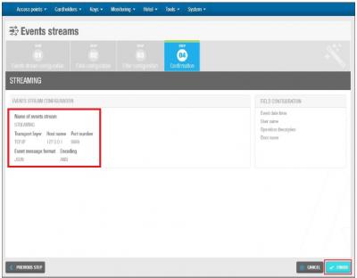

Create a resident script with 0 sleep time. In Salto set transport layer mode to UDP, use LM IP as Host name and set port to 9999. Check what you get in Logs tab in LM when an event happens on the Salto side. Keep message format as JSON to check whether JSON is valid or not.

Hello ! It's been a while since I texted you. I can only try it now. It outputs the LOG section like this:
* string: [
"EventDateTimeUTC": "2023-02-07T03:33:58Z",
"OperationID": 17,
"OperationDescription": "Door opened (key)",
"UserName": "MASTER",
"DoorName": "201"
Can you help me? For example, now I want to get the values of the fields in "String" , for example "MASTER" or "OperationID" to assign to an address 1/1/0 ?
