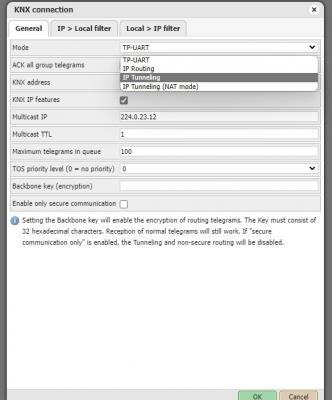

Export objects between neighbours (two spaceLynks) - Krists - 16.12.2022 Hello. I have two spaceLYnk controllers. They operate on the same network, but different lines! It is necessary to see the status of some groups, so I have done an object Export from #1spaceLynk to #2spaceLYnk. It is possible to turn objects ON and OFF from both sides, but the statuss in #2spaceLYnk (for which objects are imported) does not change when #1spaceLYnk turn object ON/OFF! #2spaceLYnk doesn't see that the object is ON or OFF. Where could be the problem? P.S. spaceLYnk firmware version 2.8.0 RE: Export objects between neighbours (two spaceLynks) - admin - 16.12.2022 If both devices are on the same network you can use KNX/IP routing (multicast) for object exchange. RE: Export objects between neighbours (two spaceLynks) - Krists - 16.12.2022 (16.12.2022, 13:43)admin Wrote: If both devices are on the same network you can use KNX/IP routing (multicast) for object exchange. Then I need to switch KNX connection Mode from TP-UART ---> to IP routing? RE: Export objects between neighbours (two spaceLynks) - admin - 16.12.2022 No, keep the connection mode set to TP-UART. Make sure that both devices have IP features enabled and that Multicast IP is the same. Also check that filtering is disabled. You can enable it later once you've confirmed that communication works correctly. Depending on how the local network is configured you might need to increase the Multicast TTL value but usually it is not needed. RE: Export objects between neighbours (two spaceLynks) - Krists - 20.12.2022 UPDATE for this post. I connected the third spaceLYnk (#3 building - same network, but different building and line) and tried the same steps. In this case, absolutely everything works!! ![]() Different for building #1 is that there are installed several line couplers (10 lines in total). Question: Can multiple line couplers cause previous malfunctions (wrong status for imported objects) if in filter table are filtered specific groups? Where would it be more appropriate to add the spaceLYnk controller in such case (in main line or it doesn't matter) ? RE: Export objects between neighbours (two spaceLynks) - Daniel - 20.12.2022 With 10 lines traffic is probably too high. RE: Export objects between neighbours (two spaceLynks) - Krists - 18.05.2023 (16.12.2022, 14:03)admin Wrote: No, keep the connection mode set to TP-UART. Make sure that both devices have IP features enabled and that Multicast IP is the same. Also check that filtering is disabled. You can enable it later once you've confirmed that communication works correctly. Depending on how the local network is configured you might need to increase the Multicast TTL value but usually it is not needed. Hello, How can I test if my routers SL are connected in multicast? Is something like "ping" function between them? RE: Export objects between neighbours (two spaceLynks) - Daniel - 18.05.2023 By default they are all connected via multicast. Create same object in both and see if value is updated after change. RE: Export objects between neighbours (two spaceLynks) - Krists - 19.05.2023 (18.05.2023, 12:21)Daniel Wrote: By default they are all connected via multicast. Create same object in both and see if value is updated after change. I already EXPORT object from #1SpaceLYnk to #2SpaceLYnk, but value dont changed (value change just in main SpaceLYnk) All FILTERS are disabled ('no filter'). Multicast addresses are the same. I also changed TTL from 1 to 5..6.. etc (there are about 5switches/routers between KNX routers) The IT service claims that everything is fine with them. Therefore, I want to prove that they did not create something correctly. But how? RE: Export objects between neighbours (two spaceLynks) - admin - 19.05.2023 You can run Wireshark on the same network using ip.addr==224.0.23.12 filter to check KNX multicast traffic. RE: Export objects between neighbours (two spaceLynks) - Daniel - 19.05.2023 You can take a switch, connect both SLs together and then show to IT that it works and it doesn't on IT network. RE: Export objects between neighbours (two spaceLynks) - Krists - 19.05.2023 (19.05.2023, 06:35)admin Wrote: You can run Wireshark on the same network using ip.addr==224.0.23.12 filter to check KNX multicast traffic. Yes, this could be an option. Thank you (19.05.2023, 07:34)Daniel Wrote: You can take a switch, connect both SLs together and then show to IT that it works and it doesn't on IT network. It could be complicated because SLs are located in different buildings and disconnecting them from the knx network would not be desirable at the moment. But thanks for the idea |
