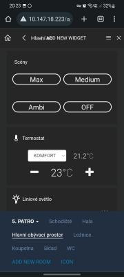

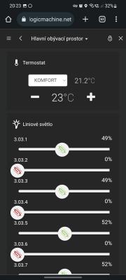

Mosaic widget order - tpospichal - 01.02.2023 Hello I have installation with multiple cloud users. I need to rearrange widgets for all of them (same widget order) How can I achieve this? Rearranging widgets by admin account on local network does not work. What is the logic with widget ordering how it is dependent on user account and resolution? I have latest firmware and lates Moxaic build. Thank you RE: Mosaic widget order - admin - 02.02.2023 Did you sync after changing the order? The order has to be changed in Mosaic admin (editor) mode. Otherwise the sort order is stored locally on the device that you are using to access Mosaic. RE: Mosaic widget order - tpospichal - 06.02.2023 (02.02.2023, 08:34)admin Wrote: Did you sync after changing the order? The order has to be changed in Mosaic admin (editor) mode. Otherwise the sort order is stored locally on the device that you are using to access Mosaic.Hi I synced, in some rooms it works, but for example I have three screenshots editor, local and cloud. Last change (widget order) was made in editor. But in cloud and local ordering is different. Is there any way how to reset ordering on all devices like it is in editor mode? RE: Mosaic widget order - Daniel - 07.02.2023 Clear browser cache |
