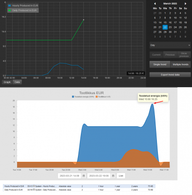

Cloud trend is not showing same data as regular trend.
I'm gonna attach picture...
On one chart 18.25 is at 14:00 (this is right time) and in cloud it shows 15:00 what is wrong...
How to correct this?

Weird part is that when enabling "Live" mode in settings and when refreshing page, chart gonna take end time correctly. But data is one hour in future(hidden)...
Also chart doesn't show until end time. Example start time 00:00 and end time on the same day 14:39 then last part what is visible in chart is 13:00 (picture added)

There's a difference how Mosaic and Trends display the time value. It is not a fixed time but rather a time period which depends on the resolution. Mosaic displays period start, while Trends displays period end. This will be fixed in the next firmware to make the value consistent.
RE: Cloud trend time is in future - fleeceable - 23.03.2023
I found that I had old mosaic FW. After update now mosaic data is not one hour in future but one hour in past.
Trend shows numeric data at 14:00 and mosaic trend shows same data at 13:00.
But like I understand that will be fixed with next FW update.

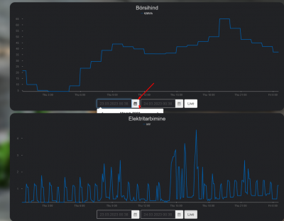

Also found one bug... If using two trends and try to change on first trend date and time then it's behind another trend. Picture attached...
RE: Cloud trend time is in future - admin - 24.03.2023
Thanks for the bug report, this will be fixed in the next mosaic version.
