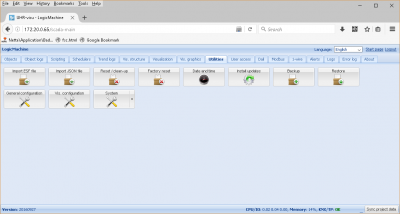

Bacnet tabpage is missing - Thomas - 28.11.2016 Hi I installed bacnet package according to this help http://openrb.com/logicmachine-as-bacnet-client/ But I don't see the bacned page showed here: http://openrb.com/wp-content/uploads/2014/07/bacnet_client_logicmachine.png A printscreen of what I see is attached My configuration: LM4 Version: 20160927 Bacnet package: genohm-scada-bacnet 20150727 I restarted LM but it didn't help. RE: Bacnet tabpage is missing - admin - 29.11.2016 You need to update BACnet package: https://dl.openrb.com/lm-16.09/pkg/genohm-scada-bacnet_20160628_mxs.ipk RE: Bacnet tabpage is missing - Thomas - 29.11.2016 Thank you Now it works! |
