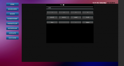

In my installation I have a Denon AVR which has a web interface to control it. I wanted to include this feature in my visualisation uing an iframe, but while trying to do this I came upon some strange behaviour with different browsers.
On Linux when using Firefox, Chrome, Opera, only one half of the page is loaded (screenshot 1).

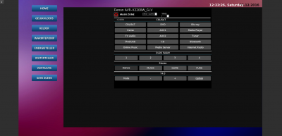

On Linux when using Qupzilla, rekonq, the page is loaded correctly (screenshot 2).

The half that is displayed is actually the bottom half but it stays on the top of the page.

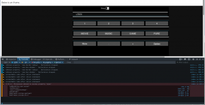

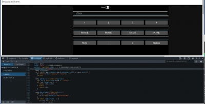

Since this seemed to be browser related, I made a simple html page with an iframe in it to show the AVR page.
Screenshots of the console are attached. There is an error related to some permission denied.
Why would it be denied permission in one browser and not in another?
