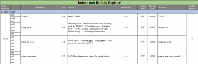

Hello dears,
Does any one connect to SAKURA VRF System?
is it possible to make the bit mask for the R/W holding register using profile?

Most likely the real address of this holding register is 0 not 40001.

{       "name": "On Off",   "address": 0,   "value_custom": { "1": "Off", "2": "On" },       "bus_datatype": "uint8",       "datatype": "uint16",       "type": "register",   "value_bitmask": 0xC000,   "writable": true,       "write_bitmask": true     }
