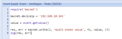

I've already have a event script on my ventilation, as my picture is showing.
How does I create a event script on 10/0/1 that will set new value on 29/0/6?

I've should have mentioned that 29/0/6 is a 1 byte value. So 0 - Stop, 1 - Low, 2 - Home, 3 - High.
So I when the value from my touchpanel is 0, I want it to set the value to 2 (Home), and with 1 to 3 (High).
