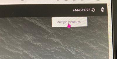

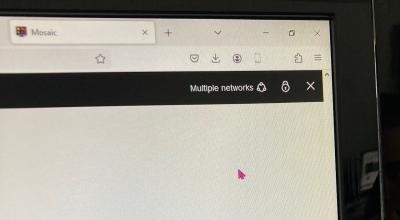

I have a couple peculiar issues with Cloud users.
The user has access Mosaic, Schedulers and Apps.Mosaic. Startpage: Mosaic
If my user is not the admin, I can't show Schedulers in Mosaic as iframe. It also won't show me the Close button in the top right corner to close Mosaic. I have to switch to Multiple networks. And then I can close the Mosaic to gain access to schedulers of the same LogicMachine.
After that I tried to switch to Startpage: Standard but still just got into mosaic.
What am I doing wrong? Huh
Thanks for your help
Cheers
RE: LogicMachine Cloud with multiple users? - Daniel - 26.07.2024
Did you gave the users permissions in LM? Make sure to sync after. There is option to hide close button in mosaic settings.
RE: LogicMachine Cloud with multiple users? - xxyzz - 26.07.2024
I knew that I was missing some mundane detail.
Huge Thanks!
