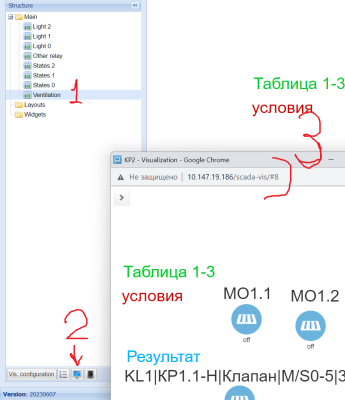

use of plan ID - gdimaria - 15.11.2023 Hi, I need to make a external link to another LM's page. ( i.e. plan with ID=2) What is the correct sintax to put after " http://ipaddress/scada-vis" ? Thanks Peppe RE: use of plan ID - Daniel - 16.11.2023 IP/scada-vis/#2 RE: use of plan ID - AEK - 16.11.2023 (15.11.2023, 18:11)gdimaria Wrote: Hi, I need to make a external link to another LM's page. ( i.e. plan with ID=2) RE: use of plan ID - Novodk - 16.11.2023 You need to get the ID from the Vis.structure tab:
