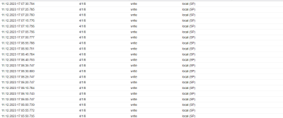

I cannot understand where the 'write' command originates. Could someone please explain what 'local(SP)' means?

It is not any default system source but any app can have a custom and this one most likely comes from Bacnet client app
RE: local (SP) - Osvaldas - 12.12.2023
(11.12.2023, 15:32)Daniel Wrote: It is not any default system source but any app can have a custom and this one most likely comes from Bacnet client app
Thank you, Daniel. You have saved me from a lot of headache Smile
It truly was a BACnet client app. I mistakenly assigned this address.
