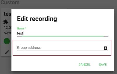

I would like to implement a presence simulation that is to be started automatically via an "absence Group Address". This GA is a boolean that specifies whether absence is active or not. If this GA is "true", the presence simulation should start playing.
For this purpose, I recorded my GAs for a week using the presence simulation app. That worked. I can now start the simulation by pressing manually the "Play button".
When I edit the recording, I can assign a GA (see print screen). My expectation now would have been that if this GA is set to "true", the recording will be played. But this does not work. Even if the GA is set to true, the recording is not played. Have I misunderstood something here? Can playback not be triggered via this GA?

Thanks for the feedback. My problem is that the playback of the recording cannot be triggered at all via a GA or an event script. Even if the GA is set to true (e.g. by setting the value manually), the recording is not played. That's why I'm wondering whether triggering via a GA is even possible or whether I'm getting something completely wrong...

When you create a recordening, or edit a exiting one you can add an binary object, when the object is false it records, when it is true it is playing back the recording...
If you don't have an object attached you can do it manual via the stop/pauze icon on the recording container, this icon disapears when you attached the recording to an object..

Thanks for your hints. I got it working now:
When you create a new recording, you must have to create a GA via APP (*/*/* or a new GA) - See Screenshot. The App will then create a new GA. The GA created can then be used to start recordings (0) or to switch to play mode (1).
What does NOT work for me is to create a recording without a new GA and then subsequently assign an already existing GA. In this case, the recording woll not be controlled via GA.
For me, control via GA is only possible if a separate, new GA is created by the APP, same time when the recording is created.
