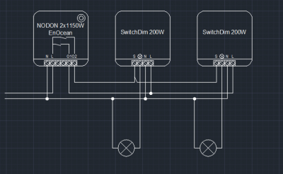

1-pushbutton dimming - Krstfr - 05.01.2017 Hello! I was wondering if anyone could help me with scripting a 1-pushbutton dimming. The idea is to control an in-wall switchdim with an EnOcean 2-channel relay. The button will only be controlled from the LM visualization. Output 1 (O1) will switch the light on/off (Short push) and Output 2 will dim the light up/down (Long Push only). I want to be able to know if the light is turned ON or OFF in the visualization, that's why I've chosen to use 2 outputs. See the attached drawing. Is there a way to also implement a push button in the touch visualization instead of the toggle-switch? Thanks! RE: 1-pushbutton dimming - admin - 05.01.2017 Maybe this example can help: http://forum.logicmachine.net/showthread.php?tid=275&pid=1238#pid1238 RE: 1-pushbutton dimming - Monolithos - 27.01.2023 (05.01.2017, 11:19)admin Wrote: Maybe this example can help: Hi there, Is this possible somehow in Mosaic - push-dimming with 1 button, I mean RE: 1-pushbutton dimming - admin - 27.01.2023 Mosaic switch widget has start/stop mode for 1 bit dimming. |
