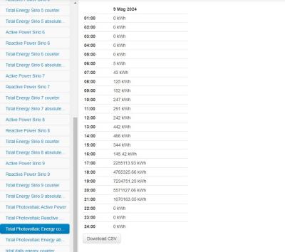

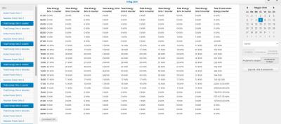

Good evening,
I can't understand what happen to my trends, a totally incorrect data and also the transition from uint to float.
Let's talk about the last column which is the sum of the previous 9 columns. The sum is done by an event script that I attached.
Do you have any suggestions?
Are the trends data editable manually for change the wrong data?
And if it is possible to change the data what program can i use for modify .trend?
-- acquisizione energia ad ogni variazione sirio1 = grp.getvalue('40/0/74') sirio2 = grp.getvalue('40/1/74') sirio3 = grp.getvalue('40/2/74') sirio4 = grp.getvalue('40/3/74') sirio5 = grp.getvalue('40/4/74') sirio6 = grp.getvalue('40/5/74') sirio7 = grp.getvalue('40/6/74') sirio8 = grp.getvalue('40/7/74') sirio9 = grp.getvalue('41/0/74') -- somma energia sum1 = sirio1 + sirio2 + sirio3 + sirio4 + sirio5 sum2 = sirio6 + sirio7 + sirio8 + sirio9 tot = sum1 + sum2 grp.write('63/7/2', tot)
