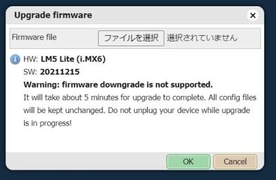

HW: LM5 Lite (i.MX6)
SW: 20211215

This problem has not occurred with LM5 Lites purchased after June 2023, so we believe that it may be resolved by updating the firmware.
SW:20230612
For example, if I update the firmware from 20211215 to 20230612, please let me know if there are any problems that may occur.
It is difficult to revert to the original version after a problem occurs, so I would like to make a careful decision.

RE: When accessing Logicmachine scada-main, the CPU load sometimes exceeds 100% - admin - 17.09.2024
In general firmware upgrade is a safe operation. But make a backup before the upgrade just in case.
