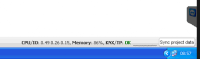

Spacelynk Memory - Krstfr - 20.01.2017 Hello! I have a spacelynk installed in a commercial office building. There are 574 objects added to the spacelynk, and there are several event-based scripts running with the same script. Code: movement = grp.getvalue('0/2/9')

endBut the spacelynk is running with a 85% - 89% load. Is this an issue? We are planning to add visualisation for 3 floors and a few more scripts for energy management, I'm just worried that the spacelynk can't handle it. Is it the scripts that are causing the memory load or is there something else? RE: Spacelynk Memory - Erwin van der Zwart - 20.01.2017 Hi, Are you running FW 1.2.0? BR, Erwin RE: Spacelynk Memory - Krstfr - 20.01.2017 Yes I am. RE: Spacelynk Memory - Erwin van der Zwart - 20.01.2017 Hi, There is a memory leak found in FW 1.2.0 and you have to upgrade to FW 1.2.1 to fix this problem. When memory is 85% the upgrade might fail. Try to stop most scripts, reboot and perform upgrade direct while memory is still low. You can find FW 1.2.1 by using the about tab in the spaceLYnk. This would solve your memory problem. Don't forgot to make back-up first to be sure (: BR, Erwin RE: Spacelynk Memory - Krstfr - 20.01.2017 I have factory reset and several reboots, even disabled the object sniffer, but it is still stuck at >85% load so it won't apply the new firmware. Any tips? RE: Spacelynk Memory - Krstfr - 20.01.2017 I went on-site and manually disconnected the power supply to restart the device, managed to update the firmware now. Thank you for the help! RE: Spacelynk Memory - Erwin van der Zwart - 20.01.2017 Hi, Glad i could help and that it worked. BR, Erwin |
