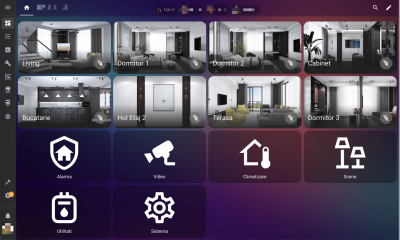

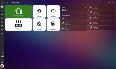

RE: New widgets - maxmp - 22.03.2025
Currently i use Home Assistant for visualization only because it fits my needs at 100%. It's responsive and has tiles (see the attached screenshots).
Therefore:
1. Can we have HTML widgets in the new visu to draw the tiles ?
2. Is it possible for the visu to be responsive ? It should look well on all devices like in HA.
RE: New widgets - admin - 24.03.2025
1. HTML widget can be added.
2. Plan view is scaled automatically to fit inside the available space. In tile view the number of horizontal tiles that is available for widgets is adjusted automatically based on the screen width. Mosaic has a option to make certain widgets smaller on smaller screens but this makes the layout unpredictable so we've decided not to include this feature.

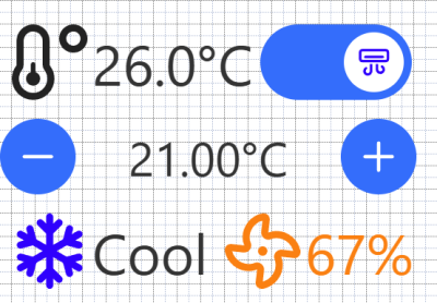

RE: New widgets - Chandrias - 25.05.2025
I have created a small custom widget for AC control, as seen in the attached picture.
I would like to have on all widgets contained in my custom widget an Enable/Disable
object, so I would link it to the On/Off object and prevent control while the unit is Off.
Additionally, on the mode widget (I used the existing Value Select), i would like the
text color to follow the selected mode color)
RE: New widgets - admin - 26.05.2025
You can specify text color for each entry in Value select widget. Display mode must be either "Value" or "Icon and value".
Disabling certain widgets can be done via Custom JS. I'll post an example later.
RE: New widgets - admin - 28.05.2025
Example of how to enable/disable certain elements depending on a group address value.
Add enable-by-0_0_1 to Appearance - Additional classes for relevant elements.

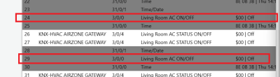

RE: New widgets - Chandrias - 29.05.2025
(29.05.2025, 09:48)Daniel Wrote: Each object with the Additional class added  enable-by-0_0_1 will be disabled when object 0/0/1 (first line in JS code) will be 0 and enabled when 1. You can change this group as needed.  You have the opacity option in the CSS code so it will be half visible when disabled.  To see result see User view, not admin.
I tried that with Group Address 3/0/4. Please check the two videos.
When I have the suggested code, I get a strange flickering behavior on the toggle switch,
while without the code I don't.
Also I noticed that LM sends the value more than once in the bus. Is that normal?
https://drive.google.com/file/d/1UVLbJVRcWKgqNiszuLlUiHOPWUwtHWdG/view?usp=sharing
https://drive.google.com/file/d/1FAEug1GpNyu609EznQMfhaDNH_1uOpwR/view?usp=sharing
RE: New widgets - Daniel - 29.05.2025
No access to the files.
