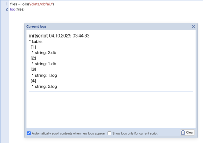

RE: All data in the database is gone after an alert - Hadeel - 03.10.2025
Thank you for looking into the inquiry!
This is what I got after executing the code.
