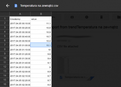

After export it is possible to import .csv file to e.g. program DB Browser for SQLite and then it is possible to use freely SQL commands to analyse this data for find e.g.:
- how many days in year was enough sunny(temp>20 and brightness>70klux) and in which month was the best for holiday?
- what would be the best angle for PV based on the last year?
- when there was no internet in house?
- how many times current temperature was very different from the setpoint and what was the reason?
- how many times in the last year there was some people in the house?
- ~~how many peoples was in the house in the las year daily based on doors(door open/2) or sensors(2 presence sensor in the hallway)?
and the otherWink

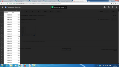

RE: Reading trends from RRD in Lua - Domoticatorino - 24.02.2018
what mail user library do you suggest? Could you shown an example please? Thanks
RE: Reading trends from RRD in Lua - buuuudzik - 25.02.2018
Here is a library which is on my LM in Common functions(but you can add it in new user library):
https://forum.logicmachine.net/showthread.php?tid=394&pid=3726#pid3726
In above post you have also an example of useWink
RE: Reading trends from RRD in Lua - Domoticatorino - 25.02.2018
Hi, great job.
in you script you wrote:
name, csv = trend_export(name, dates, 'csv', 'unixepoch')
but I think you should complete as follow:
name, data, csv = trend_export(name, dates, 'csv', 'unixepoch').
In this way I received the file by mail. GREAT.
But unfortunatey time stamp is not human readable.
Please update library, This should work:
require('user.trends_pro')
-- Export data
name = 'Kitchen_Temperature'
dates = {}
dates['start'] = { year=2017, month=4, day=5, hour=0}
dates['end'] = "now"
name, csv = trend_export(name, dates, 'csv')
-- Send an email with data
attachement = { {filename=name .. '.csv', filedata=csv, mimetype='text/csv'} }
mailattach('example@gmail.com', 'Report from trend ' .. name, 'CSV file attached', attachement)
script.disable(_SCRIPTNAME)
The result is mail with csv which has such content:
