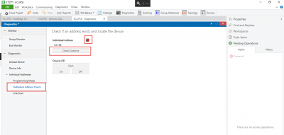

ETS Individual address check - Thomas - 19.06.2017
LM doesn't reply to ETS5 "check individual address" request (which is probably KNX ping).
Can I create a script which replies to "Check Existence" ETS button?
RE: ETS Individual address check - admin - 19.06.2017
LM does not handle any communication internally apart from group telegrams, so this is not possible.
