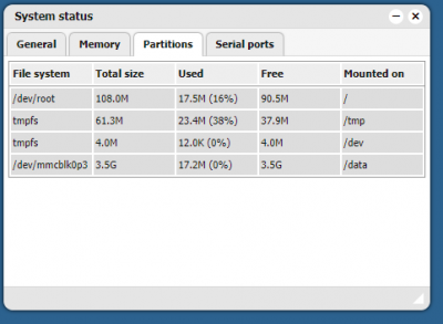

endRE: Memory Usage - admin - 12.09.2017 Run this script and post what you get in Logs: Code: res = io.readproc("ps | grep -v '\\['")
log(res)RE: Memory Usage - Krstfr2k - 12.09.2017 Code: Dummyscript 12.09.2017 11:18:34
* string: PID USER VSZ STAT COMMAND
1 root 1088 S /sbin/init
609 root 1108 S /sbin/syslogd -C16
611 root 1088 S /sbin/klogd
613 root 848 S /sbin/hotplug2 --override --persistent --set-rules-f
793 root 1088 S /sbin/watchdog -t 5 /dev/watchdog
889 root 716 S /usr/sbin/gpiod -i -l /lib/restore/defaults.sh -d /l
898 root 1092 S /usr/sbin/ntpd -n -p 0.europe.pool.ntp.org -p 1.euro
908 root 3108 S < /usr/bin/eibd -e 15.15.255 -q 100 -D -L 1 -Q 0 -T -S
912 root 13680 S /usr/sbin/redis-server /etc/redis.conf
1414 root 2412 S lua /lib/genohm-scada/core/scenes.lua
1416 root 2652 S lua /lib/genohm-scada/core/groupmonitor.lua
1424 root 2508 S lua /lib/genohm-scada/plugins/ble/bgscan.lua
1428 root 4416 S lua /lib/genohm-scada/plugins/enocean/daemon.lua
1430 root 2728 S lua /lib/genohm-scada/plugins/lmwall/daemon-sensors.
1431 root 2228 S lua /lib/genohm-scada/plugins/lmwall/daemon-led.lua
1432 root 2552 S lua /lib/genohm-scada/plugins/lmwall/daemon-apds.lua
1434 root 2552 S lua /lib/genohm-scada/plugins/w1/daemon.lua
1453 root 1576 S owserver --i2c=/dev/i2c-0:0 -p 127.0.0.1:4304
1458 root 2300 R lua /lib/genohm-scada/core/scripting-resident.lua 26
1462 root 2224 S lua /lib/genohm-scada/core/scripting-resident.lua 28
1468 root 2324 S lua /lib/genohm-scada/core/scripting-resident.lua 32
1509 root 3648 S nginx: master process nginx -c /etc/nginx.conf
1510 root 5848 S nginx: worker process
1524 root 1096 S /usr/sbin/crond -l 20 -c /etc/crontabs
6110 root 2540 S lua /lib/apps/daemon.lua zwaveapp /home/apps/store/d
6148 root 2148 S /home/apps/usr/sbin/zwave /home/apps/usr/share/openz
6149 root 7780 S /home/apps/usr/sbin/zwave /home/apps/usr/share/openz
8746 root 1092 R psRE: Memory Usage - admin - 12.09.2017 That looks normal, do you have many trends created? Can you check how much is /tmp using in system config > status > system status > partitions? RE: Memory Usage - Krstfr2k - 12.09.2017 My trend logs are attached as a picture in the first post. I have attached a picture of the partitions in this one. RE: Memory Usage - admin - 12.09.2017 Can you provide remote access to your device? Please contact us by e-mail. |
