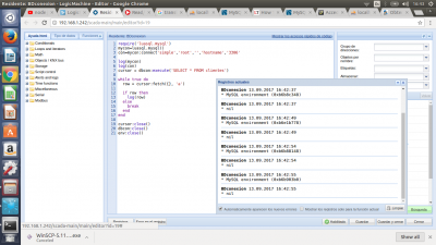

this conexion to the database is posible? using phpmyadmin? - Carlos Padilla - 13.09.2017 Hi to all it is possible to make this connection to my local server using xampp and phpmyadmin use the following address localhost / phpmyadmin RE: this conexion to the database is posible? using phpmyadmin? - admin - 14.09.2017 Yes, but instead of localhost you must put your remote server IP address. Check MySQL priviliges that user can connect from remote IPs. Also, your script has incorrect variable naming, user this example and do not change variable names: https://forum.logicmachine.net/showthread.php?tid=193&pid=798#pid798 RE: this conexion to the database is posible? using phpmyadmin? - Carlos Padilla - 14.09.2017 Hi Thanks by the help Thanks You!
