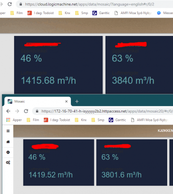

But like in the picture it dont update the value. First value is correct when i open the webbrowser but then when the value updates, the cloud dont follow.
I am pretty sure i am doing something wrong, but cant spin my head around what.

The logic machine is remote so i am logged in via an ICE remote access to the site. On lowest picture.

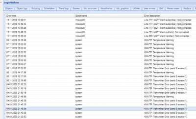

Do you have any errors in LM?

Big office building yes. And i guess that this is the problem regarding MQTT subscribe Not connected. Guess i will have to speak to the IT department then?
#10
Yes you need outgoing port 1883 to be opened. Usually all outgoing ports are open and only incoming are blocked.
