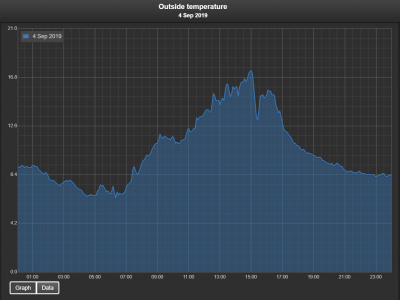

Is it possible to set the max and minimum values on the trend graph? It auto-scales but I would like to set the major and minor intervals (in this case I set 'Always show zero on Y axis). Specifically, for temperature (see example screen shot attachment), I would like to have the major increments set at 5 degrees (not 4.2 degrees as shown here). I am using the 5500SHAC (as you might have guessed).

Try this Custom JS. Change trend ID and max value as needed. You can add if statements to set maximum value for other trends. This will only work in single trend view.
12345678910111213141516171819202122
$(function(){   if (typeof Chart != 'object') {     return;   }      function getid() {     var sel = $('.nav .active .a');     if (sel.length == 1) {       return sel.data('trend').id;     }   }      var calcBounds = Chart.calcBounds;      Chart.calcBounds = function() {     calcBounds.apply(this);          if (getid() == 1) {       this.max = 1000;     }   } });

I took a good guess to set the minimum, and now I have the graph how I want it, with an easy to read 2 degrees per graph minor line:
123456789
    if (getid() == 1) {       this.max = 40;       this.min = -10;     }           if (getid() == 2) {       this.max = 40;       this.min = -10;     }

dygraph is not used here. Trends use modified version of Flotr2. Log scale is not supported. Grid minor/major color can be set via Custom CSS by modifying background-color property of .flotr-grid-color and .flotr-grid-minor-color classes. Fill can be hidden like this but for all trends altogether:
Flotr.graphTypes.lines.options.fillOpacity = 0;
if i have a multiple trend with 2 different scale ( right and left ) how i can set the right scale?
thanks!
You can set this.min2 and this.max2
